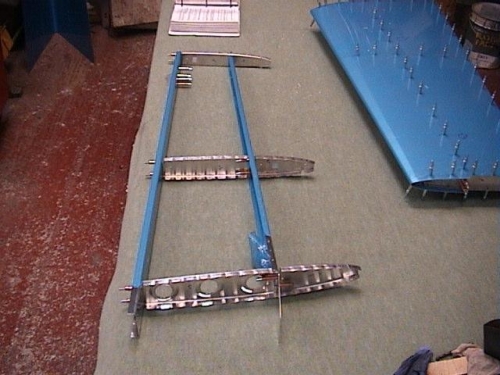

Brief Description:  Emp spar reinforcement/V-stab skeleton

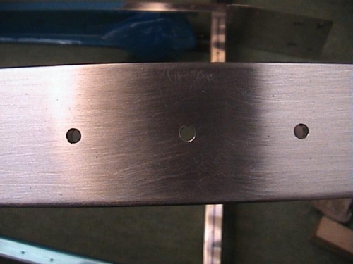

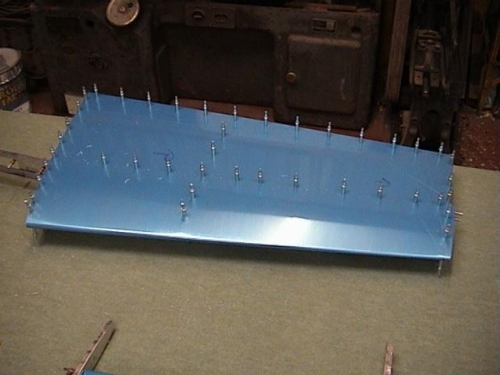

Polishing the extruded spar reinforcement bar, this is an extrusion and needs considerable work to remove all tooling marks and also needs trimming /rounding at both ends.Clecoe LH skin in place.Vertical stabiliser skeleton ribs need fluting and straightening and edge polishing. I have used 2 pack etch primer supplied by Auto Paint International @ £9.00 per 2 litres.
