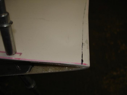

Re shaped the wing tips to match the ailerons in trail.
This is the amount that needs trimming back

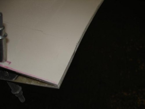

I used an air belt sander with a zirconian grit belt

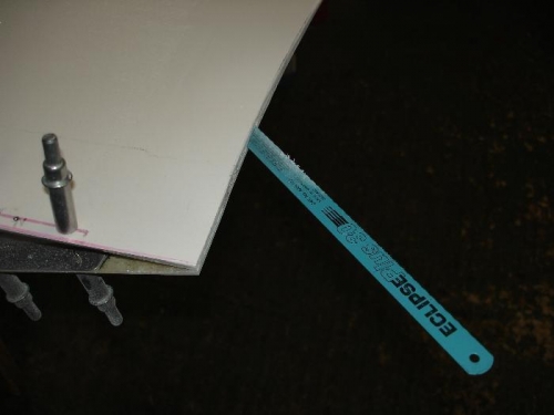

Used a hack saw blade to part the trailing edge
