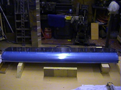

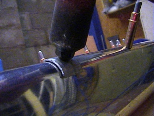

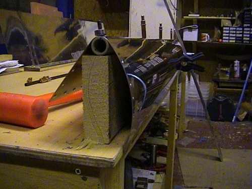

Brief Description:  Leading edge of ailerons
((2) This is how I dimpled the leading edge of the elevator. First countersink the steel pipe, place it all on a block of wood and use the male dimple die, extension and mallet to form the dimple.(3) I cut a section from a piece of aluminium tube and placed it between rivet and gun to help pull the rivet to the curve of the leading edge.
Completed aileron
