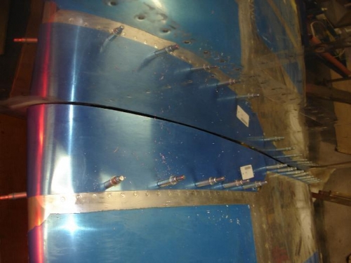

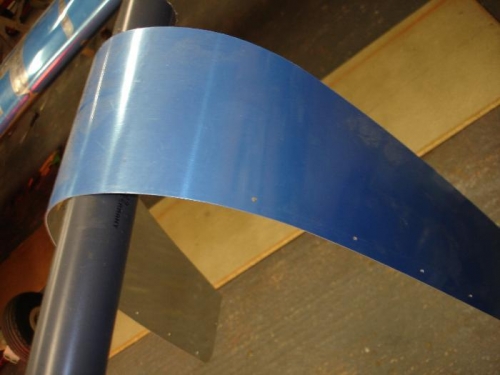

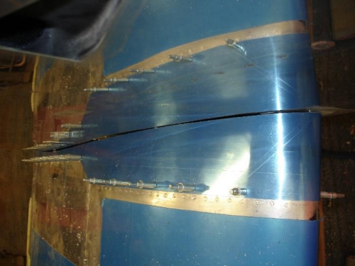

Date:  1-3-2010
Manual Reference:  W 70
Brief Description:  Wing root fairings
Post 5 of 5.
Had a bit of a struggle fitting the first root fairing, so I kind of pre-formed the second one over a piece of plastic pipe. It worked a treat. I dimpled the two pre punched holes for the upper and lower screws, made shure the outboard edge was equidistance from the line of rivets, smoothed drilled and clecoed working bottom to top.
