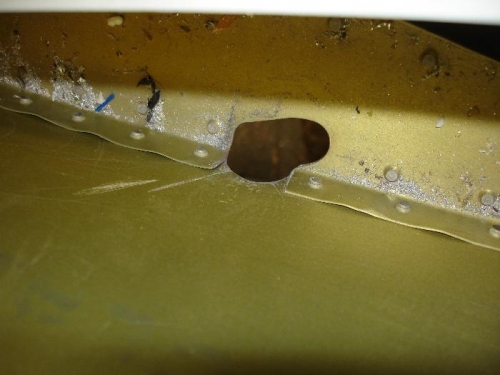

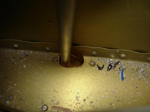

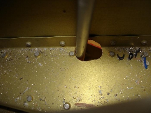

Stbd flap push rod hole
Post 3 of 5.
2nd stage of flap
At about 25 degrees it becomes obvious that the other rivet is going to get the chop
Dont forget to trim the flange away to prevent the jam nut catching
