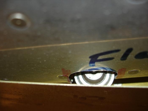

Mark the lower skin and take your weapon of choice (I used a die grinder with tungsten cutter) and cut just enough to clear the rod end. Then join the lower and side holes, fit the push rod and connect to the actuator.
The initial trim
The initial trim

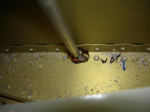

Fit the push rod and adjust for length flap retracted
Lower flap 10 degrees and check clearance
