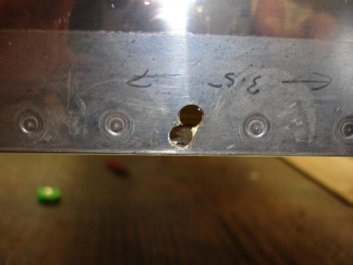

Now I could have made a paper template of the other side, but I thought better of it incase of discrepencies. This is the way I tackled it.
Opened up the pre punched area in the side

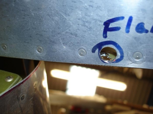

Opened up the rivet hole in the bottom

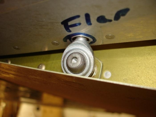

Fit the push rod end with the required washers
