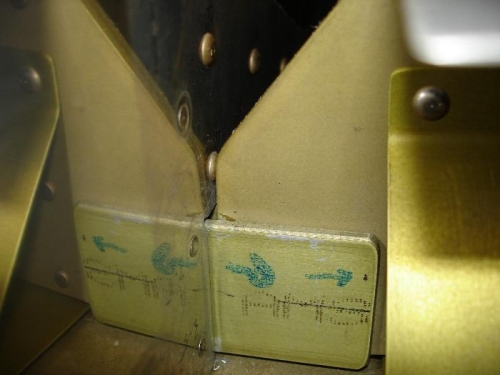

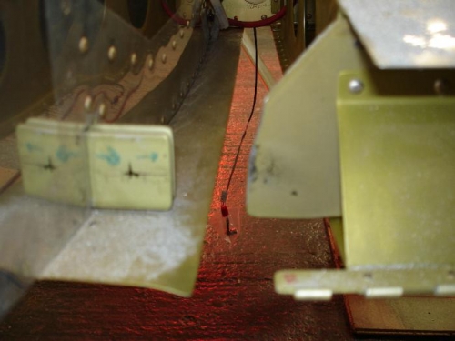

Alligning the wings
The wings need to sweep back a little more, but the rivet heads just above the rear spar attach points are in the way. So choices, drill them out and fit cs rivets or trim the rear spar ends a little more. I went for the latter.
Rivet head hitting end of spar
Same deal on stbd side
Sanded about an 1/8th away same on other side
