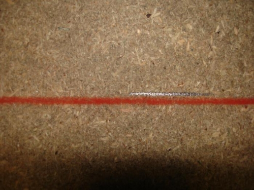

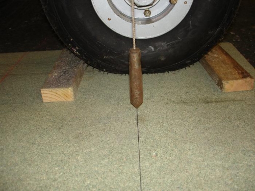

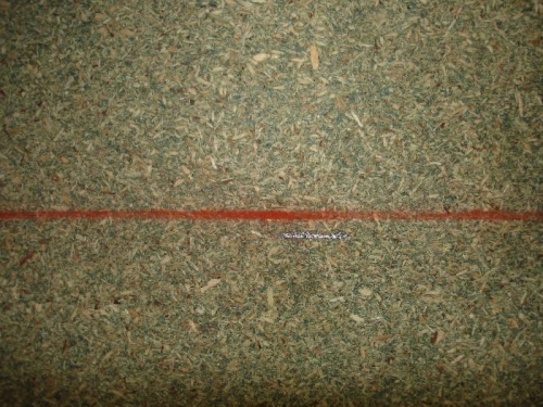

So now the wings are on I squared them with the fuse by measuring from the aft most rivet hole at the tip to the screw at the rudder cable exit. I dropped a plumb bob inboard mid span and at the tip of each wing leading edge,then transffered amark 10" aft to clear the wheels. I snapped a chalk line from tip to tip, both wings need to sweep back, the stbd showed a 3/16th error and the port about an 1/8th
Dropped a plumb bob from the leading edge
This is the amount of correction needed on the stbd wing
And this the port
And this the port
