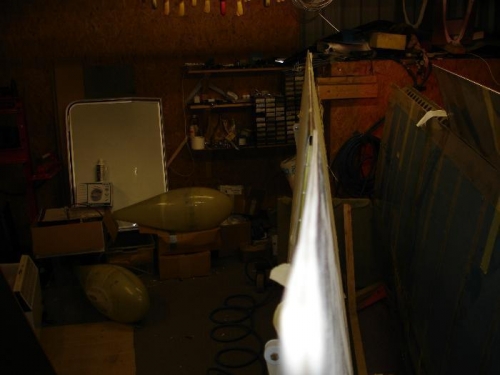

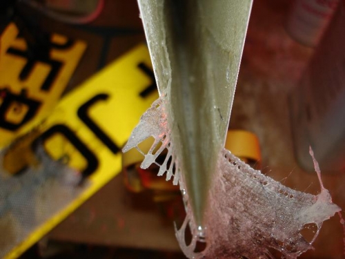

Glassed up the trailing edge of the left wing tip. The right one was warped out of allignment, and no amount of adjusting was going to fix it. So out with the hacksaw again.
Wetting strips of cloth first makes the task much easier
An old hacksaw blade gets it right into the tip
The right tip needs the twist taking out of it aswell
