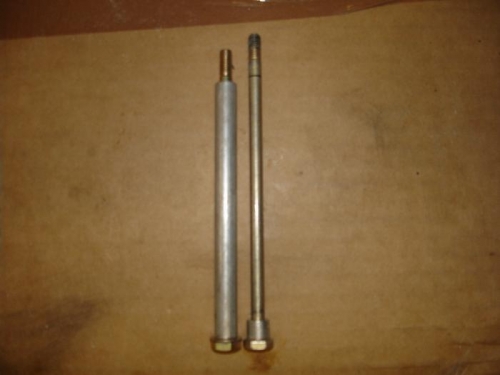

Brief Description:  Oil cooler bolt
For some reason Vans gives you three bolts the same length and have you make a spacer to effectively shorten one of them. I was not happy with the clearance from the engine mount, so I ordered and fitted the next size down, sorted.
Vans supplied bolt with spacer on the right, new shorter bolt on left
