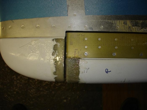

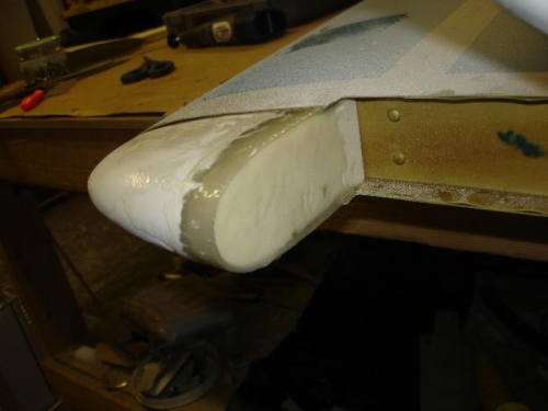

Worked on the empennage tips tonight. Cut a pu foam closing rib and glassed it in place. I also covered the lead to make painting easier.
Hard to see but glassed over the lead
Also closed off the tip
Left the gap slightly wide to allow for filler and paint
