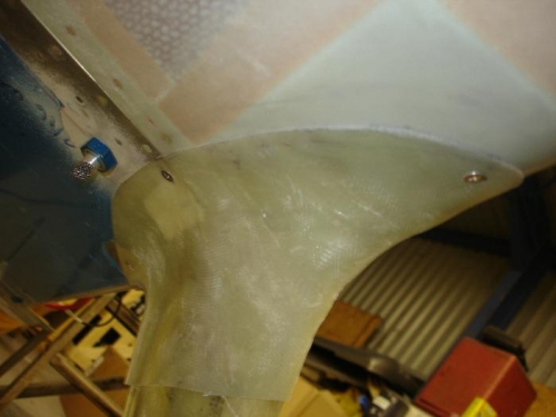

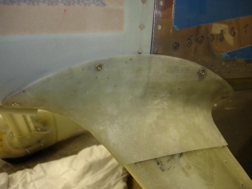

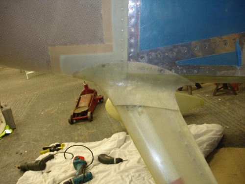

Upper intersection fairings
Riveted the nut plates, tapped the holes through the longerons to fix the fairings, quite pleased with the fit after all.
Gone with #6 screws
Tapped the rear one through the longeron
Tapped the belly one through the flange and hinge
