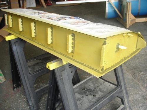

I micro shaved all the fuel tank rivets today, with a milling cutter fitted in the countersink cage. They were slightly proud due to being set with tank sealant. I etch primed the tank then fitted it to the wing. Thats both wings finished now, bar the fibreglass tips.
Primed the left fuel tank
