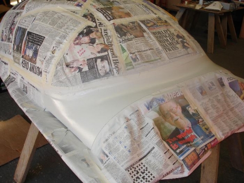

Date:  4-3-2009
Number of Hours:  12.00
Manual Reference:  F 85
Brief Description:  Canopy fairing
After lots of filling and shaping, I masked up the canopy and primed it with a two pak primer surfacer. I had previously placed several layers of tape (red,yellow and brown) so that I can gauge how close I am getting to the plexi.
After rubbing down with 320s I removed the penultimate layer of insullation tape the last one is red.
