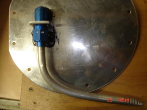

As per Vans service bulletin I safety wired the fuel pick up tube.

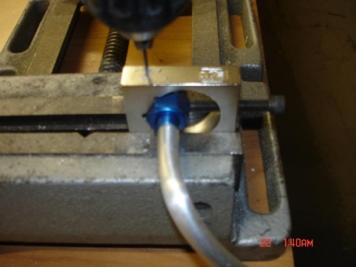

Drilling the coupling nut to take the safety wire

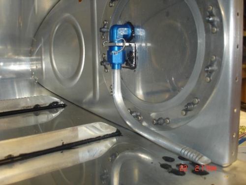

Safety wired to anti rotation bracket
Trial fitting of the assembly to the end rib
