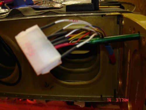

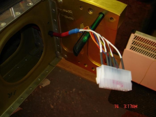

Terminated the right wing wiring in a multiplug, I originaly ran the capacitance fuel level wires with the all the others but this puts them at the wrong side of the main spar, so I pulled them back and ran them through the grommet with the vent line instead.
Wired a multi plug to the right wing root
The fuel level wires need re-routing
