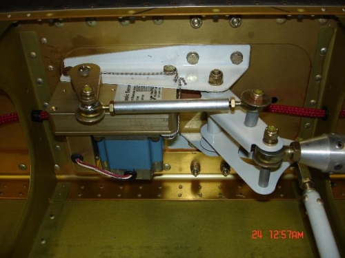

Brief Description:  Trutrak roll servo and wiring
Fitted the roll servo and brackets. Ran the wires for the servo and lights.
Trutrak tell you to reverse two of the wires in the plug if the servo runs the wrong way, but according to the installation manual the standard is anti clockwise rotation for right aileron. So if I have read this right I should not need to reverse the wires later, fingers crossed.
Roll servo in right wing

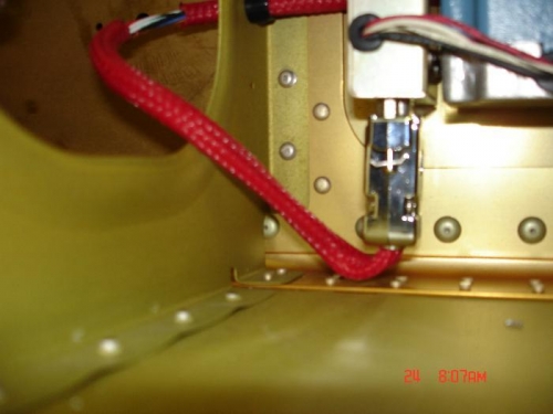

I found a shorter hood for the plug as the standard one comes to close to the top skin
Good clearance now
Good clearance now
