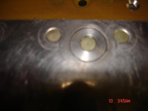

Brief Description:  Pitot tube and wiring runs
I ran the angle of attack and airspeed tubes to the pitot head, and blanked of the old pitot hole.

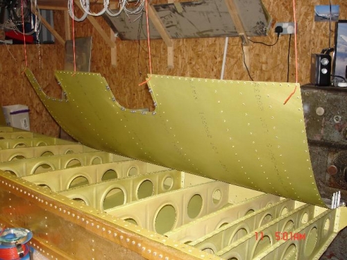

Not shure whos website I pinched this idea from, but holding the wing skins up with 16 gauge wire works a treat, just slide the wire through the rivet holes and it locks itself.

Made a plug and plate and blanked off the old pitot hole
suspending the wing skins for riveting
