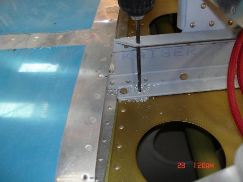

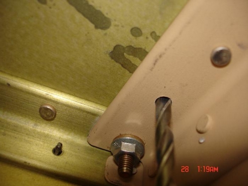

Date:  12-27-2008
Manual Reference:  E 18
Brief Description:  horizontal stab bolts
My right angled drill attachement would not drill the inner bolts, and I have not been able to find one that will, not acurately anyway. Eventually took the plunge and marked and drilled a pilot through the top angle and used it as a guide for the lower hole. Another problem overcome.
