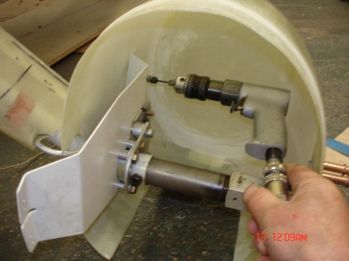

Date:  12-16-2008
Number of Hours:  4.00
Manual Reference:  G 7
Brief Description:  Wheel and leg fairings
Vans tell you to mark the inboard brackets and drill them through the translucent wheel pant, well it didnt work for me. The problem with that method is even with a torch inside the pant, due to shadowing and the fact that the bracket is some distance away from the fibreglass the holes ended up miles of. Fortunately I managed to use the misaligned holes for the nutplate rivets. I ended up removing the wheels and drilling the holes from the inside out then making up the gap with several layers of glass.

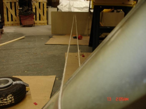

Re checked the leg fairing allignment using a better method
