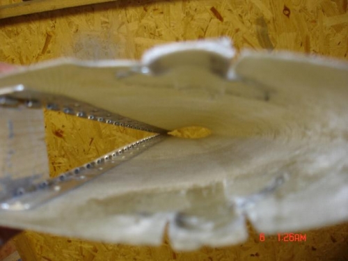

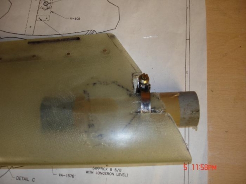

Laid up some extra plies to reinforce the fingers that hold the fairings in place, used a plastic pipe to simulate gear leg and to act as a mold.
Cleaned up ready to fit
