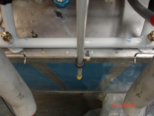

Riveted and bonded the cowl hinges in place.
made the hinge pins and retainers, drilled the lower firewall flange to hold the lower pins.
Lower cowl vertical hinge pins

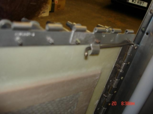

Vertical hinge pin retainer
This is how I am securing the lower pins
