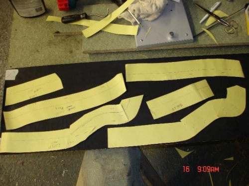

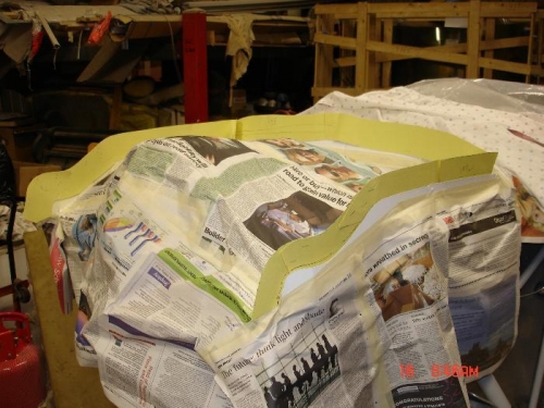

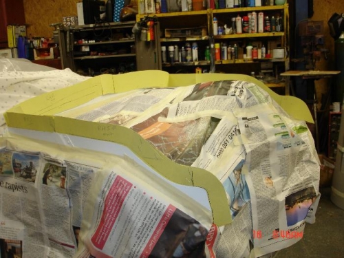

Baffle seals
I masked of the engine to stop swarf and debris getting into the works, then made up some card templates for the baffle seals.
Gone for an inch below and an inch and a half above top of baffle
