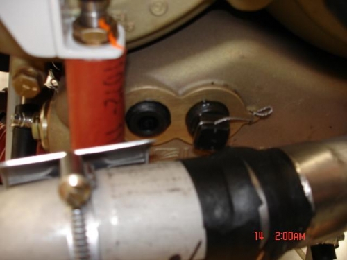

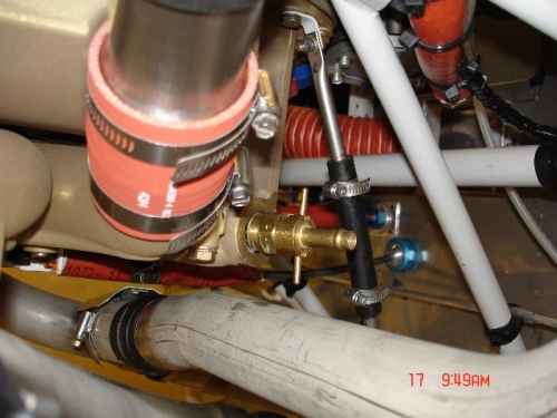

With the new sump fitted the drain plug was not going to work so I e-mailed Superior to see if It was ok to use the aft lh side plug instead, they confirmed this was ok.
Drain plug directly above exhaust (the amalg tape is an attempt to keep moisture out the engine.
New location for quick drain valve
Just needs safety tieing now
