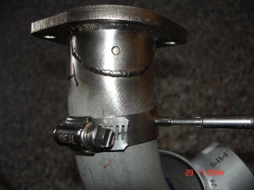

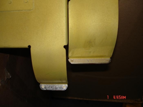

Fitted the egt probes to the four exhaust down pipes. Riveted doublers for wire ties on baffles.
2" down puts the probe in the flame front
I angled them inboard, it makes more sense to me to be able to run the wires with the cht bundle
