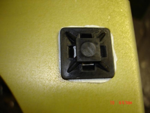

A fellow RV builder advised me not to rely on self adhesive tie wrap bases, so I have decided to bond them on with pu adhesive in critical places.

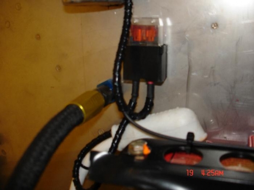

Fitted an inline fuse close to the battery this feeds the Dynon keep alive and aux socket
