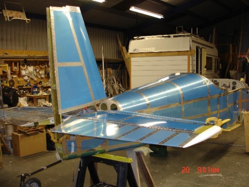

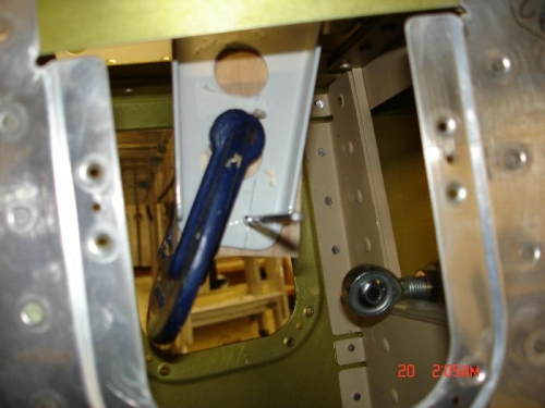

Fitted the vertical stab and set up the control tube for the elevators
Made a hardwood spacer and drilled the control horns

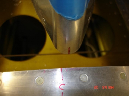

Verified the 1/4 offset to the left
