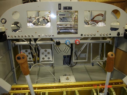

Finaly got the panell fitted this weekend, everything is buttoned up and the wiring behind the panel is all but done. Got the throttle prop and mixture controls in aswell.

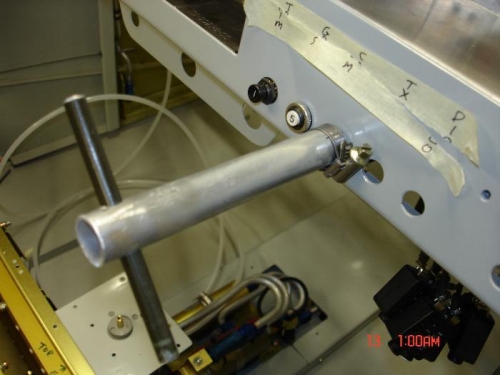

Made this tool for fitting the knurled nuts on the circuit breakers

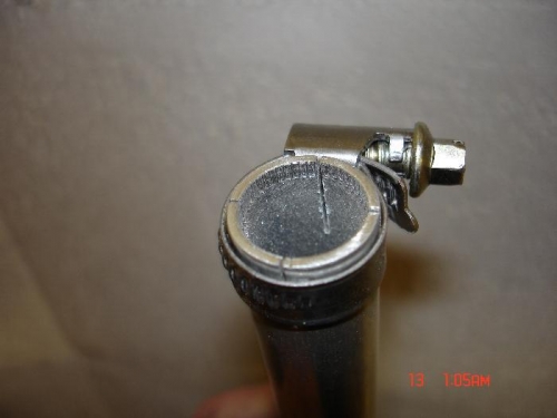

Its a piece of ali tube slightly smaller with four slots and a hose clip, works great
