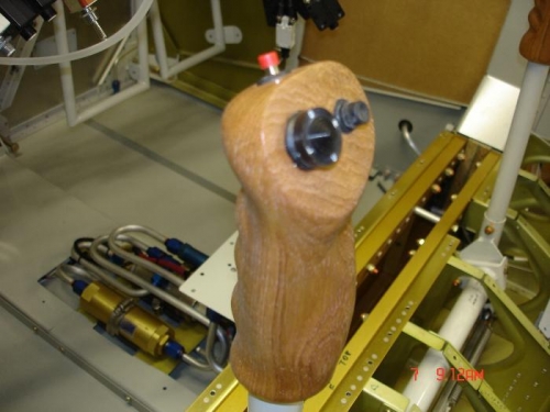

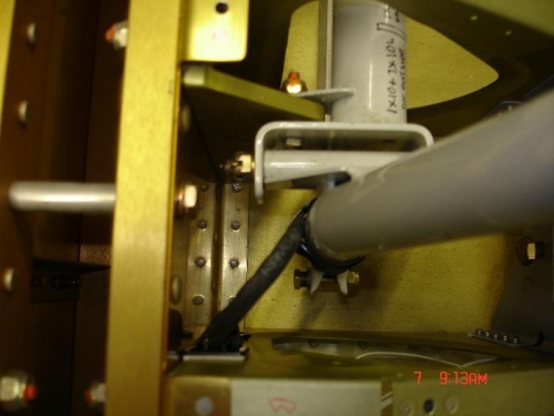

I decided to add an extra momentary switch for autopilot engage/disengage to the top of the pilot stick. I ran all the wires out the bottom of the stick then back up towards the pivot point same as other side.
Red button for autopilot engage/disengage
Bundle tie wrapped close to pivot point
