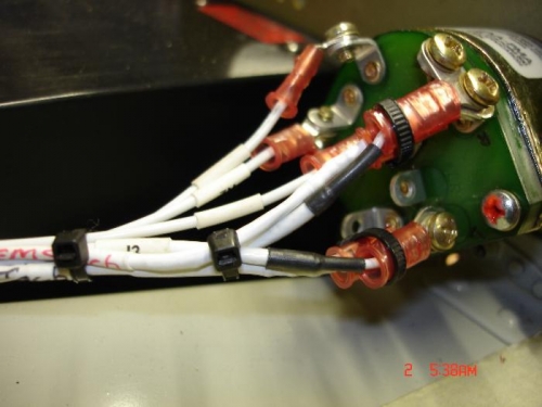

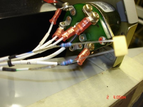

I decided to fit the resistors for the tacho function of the Dynon D120 aft of the firewall to reduce the risk of breakage due to vibration.
Soldered a piece of #22 wire to the tail of the resistors then heat shrink and cable ties

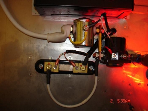

Ran the wires for the amp meter function
