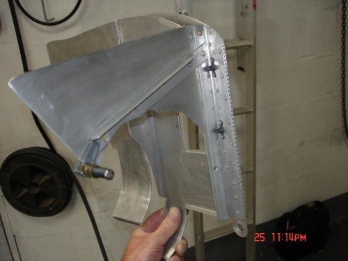

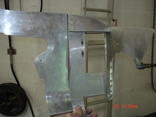

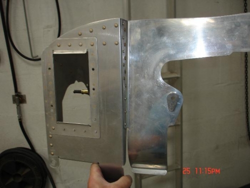

Riveting the baffles
Riveted the left rear quarter and oil filter mount together, I decided to use duralac between all the joints, then I will etch prime and spray the whole component with high temp paint.
Looking aft
Looking inboard
And forward
