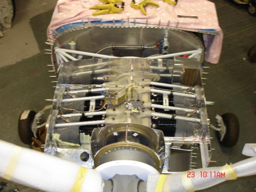

Finally got all the baffles in place tonight, just need to trim down the front and back to clear the top cowl.

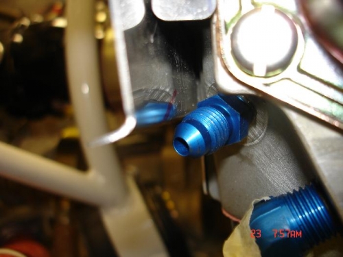

Interference issue with the manifold pressure fitting
Solved it by cutting of the flange and forming a new one slightly higher
