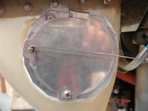

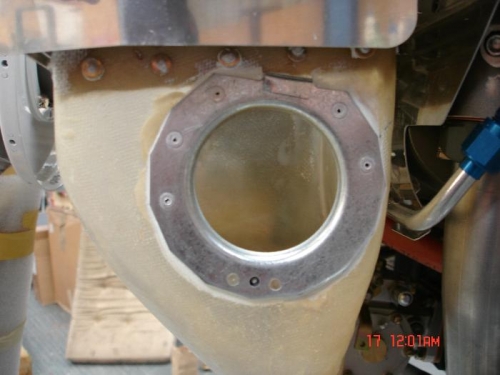

Filter bypass door
Fitted the air filter bypass door and routed the cable
Riveted housing in place using pu adhesive sealer
Routed cable through an eyeball fitting
