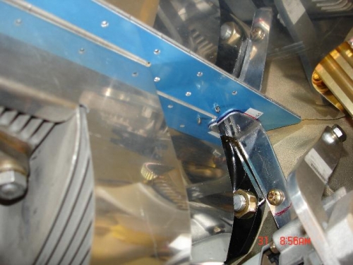

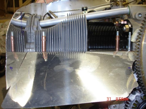

More work tonight on the left and right inlet floors.
It looks as though the airbox forward edge will interfere with the aft edge of the lower cowl inlet lip, so I will have to square it off
Right inlet floor
Right inlet floor
Trimming back the lower cowl lower inlet lip will allow the inlet floors to extend further forward
