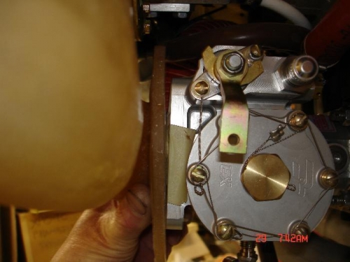

Started fitting the snorkel tonight.

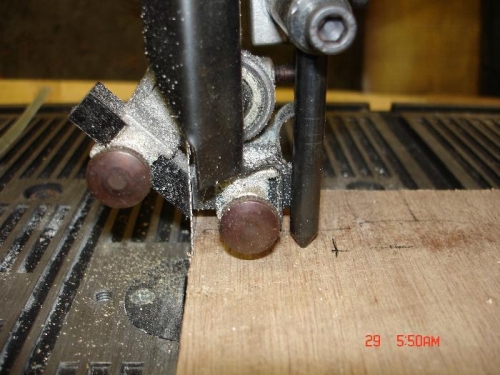

Used this circle cutting attachment on my band saw to make a plug for lining up the snorkel to servo

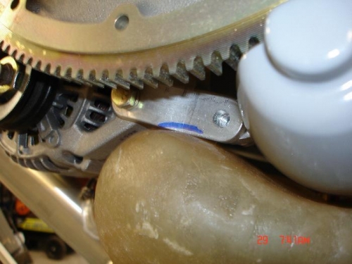

Interference issue with bottom alternator strap and boss
Its just holding it off by about 1/4" at the top
