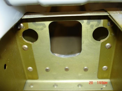

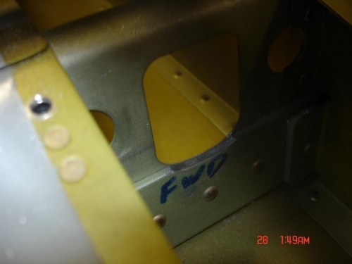

Date:  3-22-2007
Number of Hours:  1.00
Manual Reference:  C2
Brief Description:  Elevator push rod/rear spar interference issue
Something that has been bugging me for some time now is the fact that the elevator forward control rod was very slightly rubbing on the rear spar carry through. I decided to remove it and used the Dremel to lower the bottom edge of the hole slightly.
