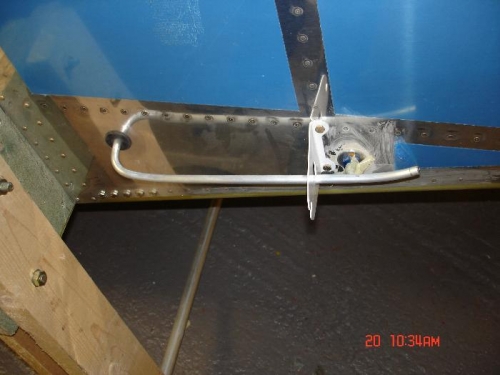

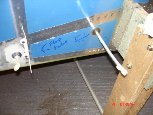

Post No 4 of 4. The right hand tank has the flop tube so the fuel pipe needs to run forward through the tank mounting bracket . The left tank has the standard pick- up so this end should connect straight to it.
Snug but tidy
Right hand pipe will go to flop tube
Left hand fuel pipe at wing root
