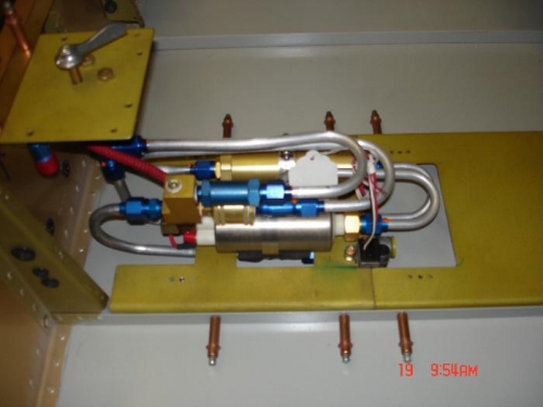

Date:  11-19-2006
Number of Hours:  4.00
Manual Reference:  S1

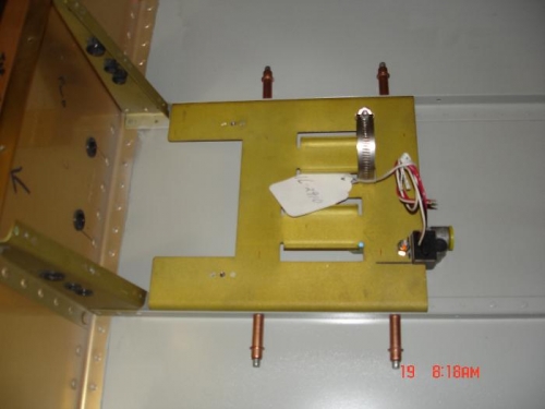

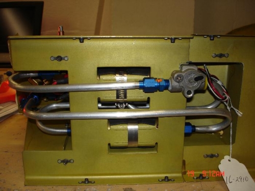

Brief Description:  Fuel flow sender
The fuel flow needs six inches of straight fuel pipe at each side of it, and it needs to be downstream of the filter. After much head scratching I chose this location, its tight but it just fits under the cover and I managed to get a bolt through the pump mounting plate to secure it.
