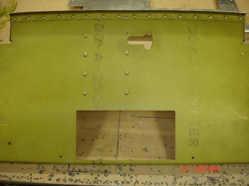

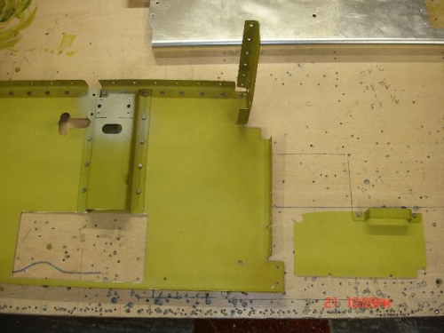

I cut the sub panel to take the rear of the tx and com trays, this entailed removing about half an inch of the hat section as well, but I decided that was a better option than cutting the bottom angle off and would keep the sub panel from distorting.
Sub panel cut
Sub panel cut
Part of sub panel and hat section removed

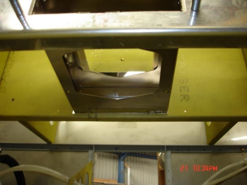

Trays protruding through sub panel
