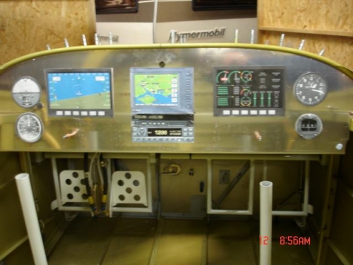

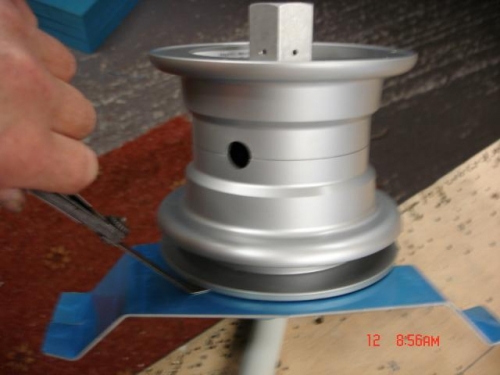

I have spent the last couple of days making some final Avionics decisions, I placed and paid for my centre stack order to Harry Mendelssohn then I worked out all the cable runs and anttena locatioms. I have gone for Bendix King KMD 150, Garmin SL 40 com and Garmin 330 mode S transponder (due to up and coming European legislation) My only concern is there is no audio input on the SL40 so I may end up having to fit a seperate intercom to get voice alerts from the mode S.Then I spent an hour playing with a wheel and brake.
Final mock up
Final mock up
I made the back plate spacers exactly to call out and the gap came out perfect
