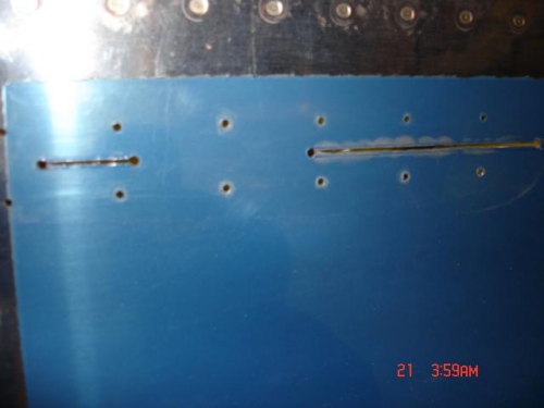

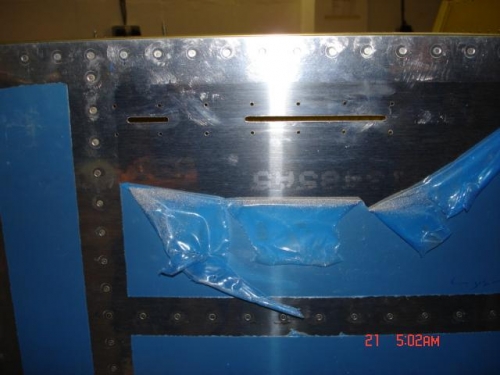

Canopy latch handle
I used a cut off wheel to join the holes
I clamped a straight edge behind the skin to guide the needle file
