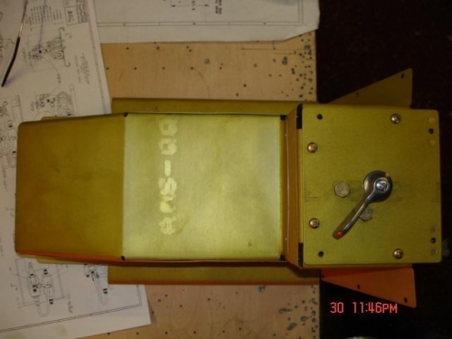

High pressure fuel pump
I dont have a 3/8 tube bender so I cut a few circular pieces from a piece of 3/8 ply, By screwing them to the bench with a further piece screwed over the top, I managed some nice tight bends without collapsing the tube.
Cover and valve assembled
Pump and filter clamped to the base
Home made pipe bender
