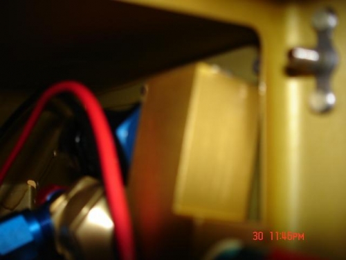

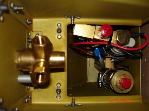

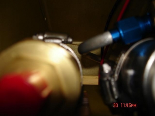

Brief Description:  High pressure fuel pump
The callout for the fuel valve spacers is wrong, mine needed to be about another 1/8th longer.I had to make a decision whether or not to dismantle the fuel pump manifold amd fittings to enable it to stand vertical on its mounting, but as this voids the warranty i decided to try it for clearance as is. There is about 1/4 " clearance on all components.
