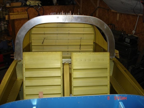

Finishing the roll bar
The act of riveting the roll bar together, made it about 1/4" to narrow, fortunately I had this porta power hydraullic ram left over from my mechanicing days, I just eased it apart to save putting undue stress on the retaining screws
