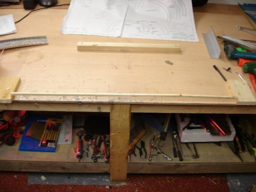

Marking the dimensions on the bench, screwing blocks of wood on those marks made it easy to remove just the right amount of material

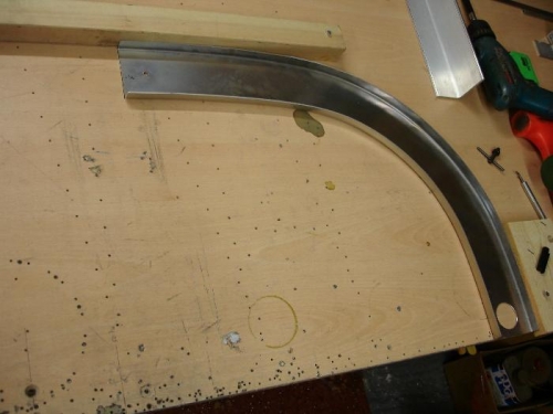

Draw a line at the inboard end onto the bench

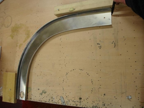

Same on the other side
