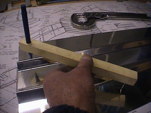

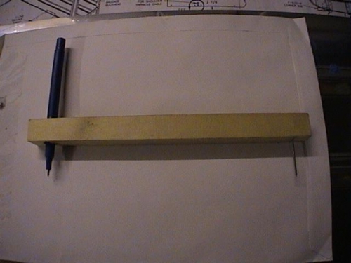

Baggage bulkhead
(1) Drill a hole in one end of a piece of wood to take a line marker, knock a pop rivet mandrel into the other end and you have no cost tool for marking the radius on the bulkhead
