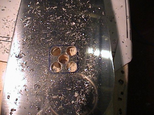

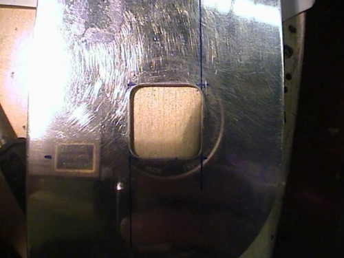

Making the hole in the deck gussets to take the canopy latch fingers
Mark and drill 5 x 1/4 holes
Use a unibit centred in a block of wood
Finish off with various files
