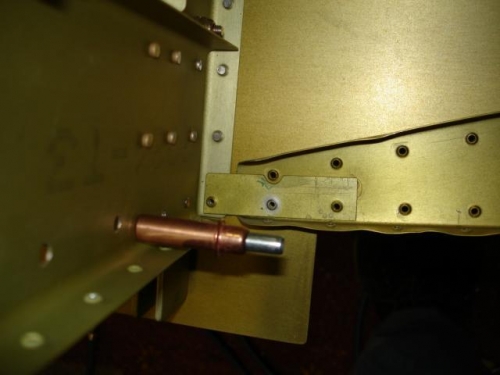

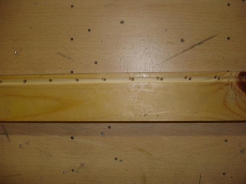

Countersinking the longerons
(1) I ran a piece of timber over the table saw a couple of times. Placing it under the longeron gave the counter sink pilot clearance.(3) No mention of this rivet being half on half off, so I notched around it.
