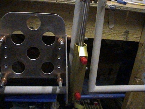

Brief Description:  Rudder pedals and brakes
(1) The bearing block is just the right spacing to hold the pedal above the rudder pedal whilst drilling(2) The brake pedal should end up in the centre of the two rudder bars when they are hanging perpendicular(3) Ready for priming, painting and riveting
